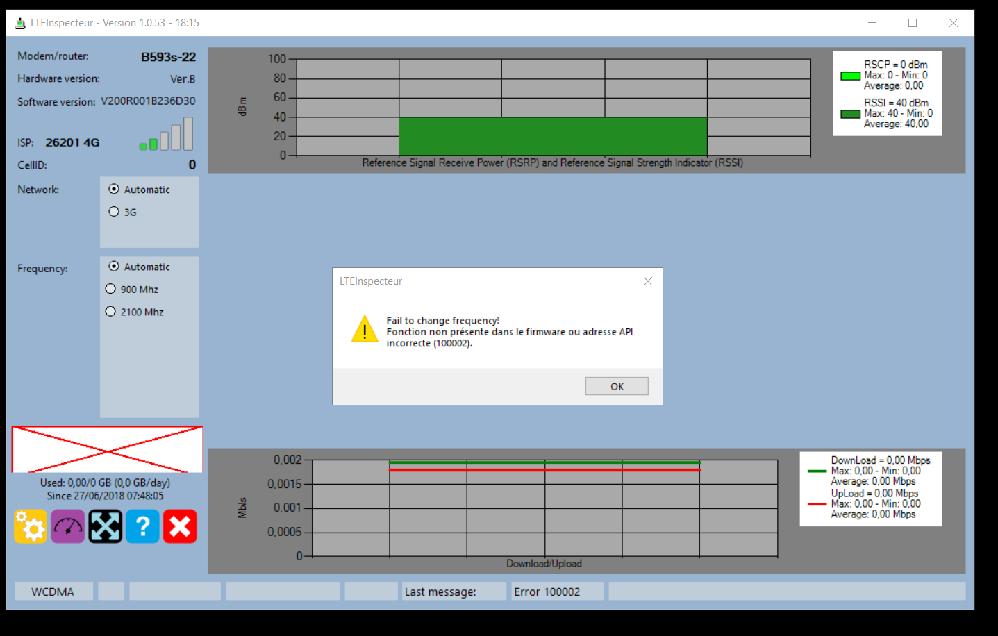

    i tried using it with a 593s-22, function is very limited.
    Network : Germany, Telekom LTE
    Model: B593s-22
    Firmware: V200R001B236D30SP00C00 (https://www.huaweiflashfiles.com/2017/03/download-huawei-b593s-22-firmware_40.html)

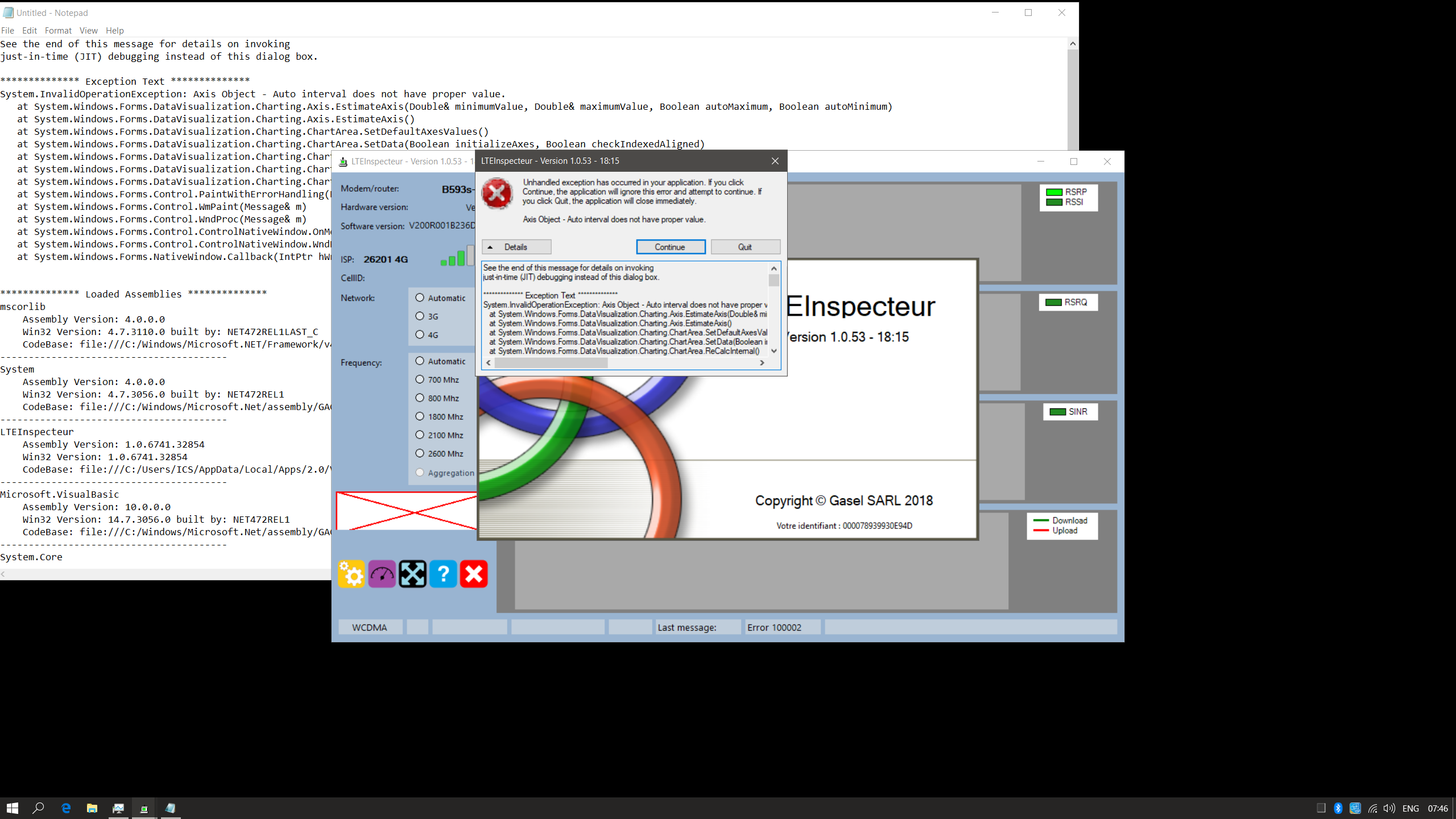

    - i cannot change frequency
    - errors starting the app (invalid update period)
    - enabling loggings throws 5x info msgboxes at the start
    ill attach the logs/screens.
    is there any chance you could add frequency change for the B593S-22? would be amazing!

    Hello sspm and thanks for the test,
    The Huawei B593 causes some problems because it is already a little old and Huawei has since changed its Hilink protocol.
    As a result, some informations are not available, as RSRP, RSSI, RSRQ and SINR.
    Instead, we only have the signal strength and the reception level from 1 to 5.
    In addition, the monthly quota information is not available, resulting in an error in the software ("Auto interval does not have a valid value").
    With this model, I do not know if changing frequency is possible. In any case, the command which works on other Huawei routers generates the error #100002 ("Command not implemented")
    On the router's web interface, is it possible to change the type of network (3G <=> 4G)?

    thanks for the reply.
    after loading the app only shows "3g" and 900/2100 mhz.
    in the webinterface i can change from 2g/3g/4g and auto
    Gasel
    Synology RT2600 + E3372 Huawei Stick
    Hi, sspm.
    I'm afraid I can not change the frequency of this modem because I have not found any information about B593 HiLink controls.
    Unless you have information on this subject?
    On the other hand, I will do my best to remove the error messages.
    Leider kann ich die Frequenz dieses Modems nicht ändern, da ich keine Informationen über den B593 HiLink protokol gefunden habe.
    Es sei denn, Sie haben Informationen zu diesem Thema?
    Auf der anderen Seite werde ich mein Bestes tun, um Fehlermeldungen zu unterdrücken.

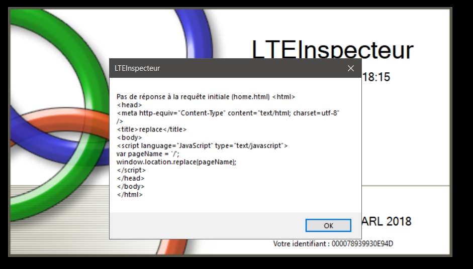

    This is the explanation of the malfunction. The software is designed to perform requests according to the Hilink protocol.
    I am even surprised that some information is still displayed, such as signal strength or reception level.

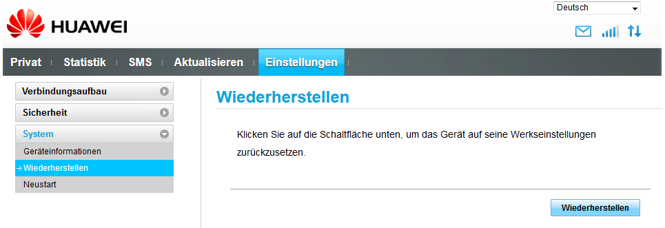

    Die Passworteingabe darf nicht aktiviert sein (Bitte Login erforderlich nicht überprüfen):
    und die Zugangs-methode muss "Automatisch" sein:
    Könnten Sie mir sagen, ob meine deutsche Übersetzung korrekt ist? Ich habe vor ein paar Jahren Deutsch in der Schule gelernt :)...
    Echankar
    Hallo, dein Deutsch ist gut!
    Ich habe diese Einstellung nicht.
    Brauche ich vielleicht ein Firmware und WebUI Update?
    Wenn ja, welche Versionen? Ist ein "S" Stick.

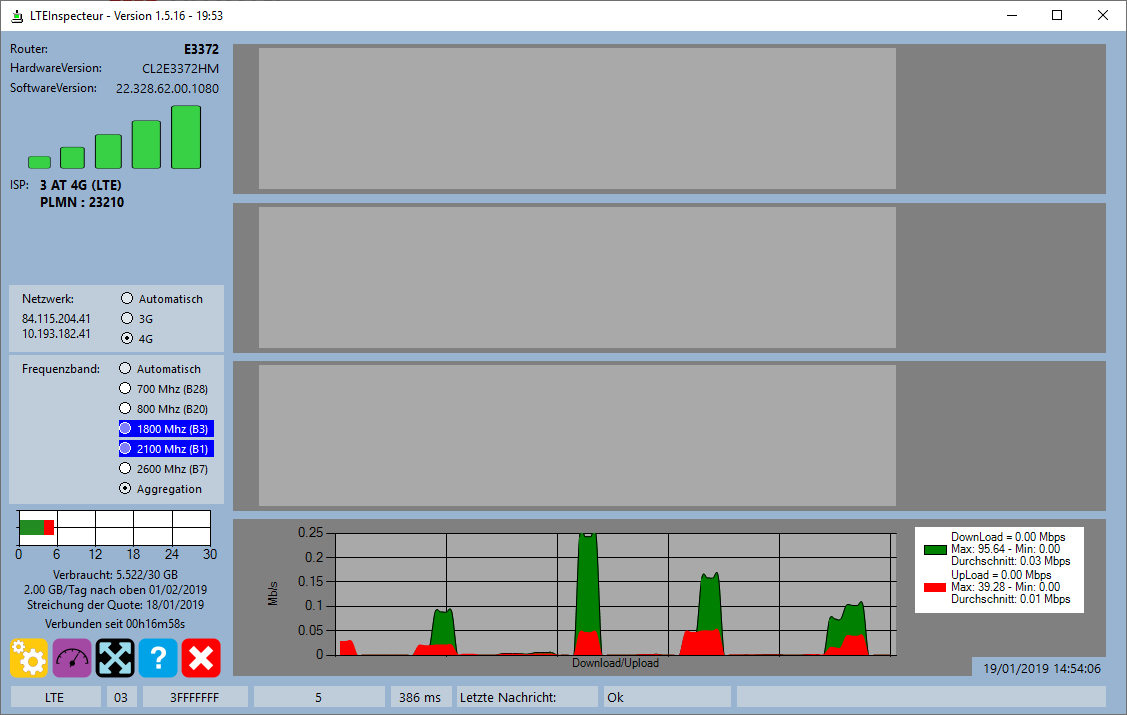

    Hey Gasel,
    endlich eine Software die mit dem E3372h funktioniert ohne, dass ich einen Firmware-Mod benötige. Vielen Dank!
    Der LTE-Watcher für Huawei ist ja leider nicht mit dem E3372h kompatibel.
    Ich benutze den E3327h an einem TP-Link TL-MR3420 mit UPC Speed 75 LTE (im Netz 3AT / Drei Österreich).
    Daten zum LTE-Stick:
    Hardware version: CL2E3372HM
    Software version: 22.328.62.00.1080
    Web UI version: 17.100.19.04.1080
    Nun zu meiner Frage:
    Leider liefern die ersten drei Statistik-Fenster nicht wie im Screenshot oben Daten zur Empfangsqualität sondern bleiben grau (siehe Screenshot). Sie blinken nur manchmal.
    Ich habe die Empfangsqualität im selben Netz mit meinem Handy und der App "Network Cell Info Lite" getestet, um den E3372h (mit USB-Verlängerung) optimal zu platzieren.
    Ich würde jetzt gerne überprüfen, ob der Stick dort die gleichen Daten zur Netzqualität liefert.
    Hat dieses Problem mit meiner Version / Firmware zu tun?
