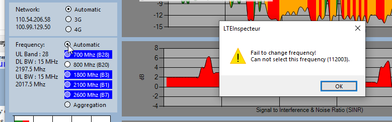

    At first start, the new one gave question marks like this
    but after a couple of attempts at selecting new frequncies, its gone back to showing a new connection duration
    Nothing wrong with that, in my opinion, I would say it would not be easy to use the connection.
    So, no exaturation, what i say saying, is no one else laid out the signal data in graphs in an easy-to-understand way for the everyday person. In the not a signal expert and i am able to understand the performance of my connection, only with these graphs. No other programmer has managed to think about the average person and make it simple to
    I put it to you, that would be a priceless tool for professional 4G antenna installers worldwide.
    now, the automatic frequency select has since become unselectable, i cant use automatic now, it used to work, but now this new version it doesnt like it.

    Well, thank you for the answer.
    Huawei routers are very difficult to manage, because of the lack of API documentation.
    Automatic mode is a good example : some routers accept 7FFFFFFFFFFFFFFF as parameter for automatic frequency selection while others require 20880800C5 or 20800800C5.
    Obviously, you live in a country with different frequency standards as in Europe, and may be the parameter is still different.
    Btw, you can try selecting "Automatic" several times. In some cases, the router eventually swallows it.
    Can you choose the automatic frequency in the web interface of the router, then run LTEInspecteur and tell me the fourth value in the status bar at the bottom (just before the number of ms) ?
    With this information, I will probably be able to do something for you :)...

    yes i think its throwing the error and just reverting to automatic anyway, meaning, it is selecting aggregation and all the router's available bands are then automatically selected.
    I will run the automatic test for you tomorrow and get back to you with those figures.

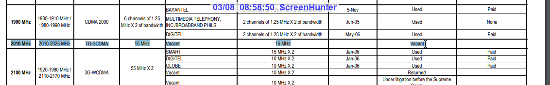

    as for the strange issue with the 2100 mhz frequency display, it simply cannot be possible, as the provider i use, Globe telecom Philippines, does not use any 2100 mhz frequencies for LTE, only for UMTS. (3G HSPA)

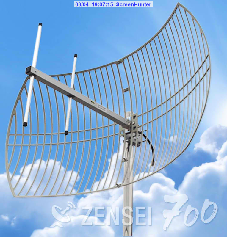

    I am using a 700 mhz parabolic dish on the primary antenna and am finding that any external antenna for the diversity antenna is significantly increasing the signal quality, but completely hampering the downlink, possibly due to interference from the primary antenna, or possibly from all the cellphones communicating with the other towers between myself and the main 700mhz tower 15 km away.

    wel, fuck me. have you ever heard of such disgusting business tactics, disguising a product as something else. Ive just gone and spent 150 AUD on 700 mhz infrastructure because they advertised that is what i was using. Absolute animals in this country.
    This would explain why i lsot so much signal quality between the time i was back workign in australia, and my return here last month.
    It looks as if this supreme court ruling was in favor of the complainant, and globe telecom just kept all there 700 mhz customers quiet by disguising something else as B28

    Since then, that court case i showed you the link for has been. so i suspect they have lost these frequencies, and are disguising the high frequency signals as B28 so that their home fixed wireless subscribers modems are still able to connect. They sold a lot of hardware designed for B28 and advertised it as twice as fast because it would penetrate and travel further.
    Now could you imagine the backlash they would receive if they left those customers in the shit? their stupid solution, i suspect, has been to just make use of these vacant frequencies i found in the Philippines national telecommuncations commisions documentation. foudn here : http://ntc.gov.ph/wp-content/upload...RNED-AND-VACANT-MOBILE-ACCESS-FREQUENCIES.pdf
    The uplink is apparently band 22 at about 3500 mhz, and i suspect they are using this vacant block for this.
    Both of these frequency badns have 15 mhz slots available, so they are a perfect match.
