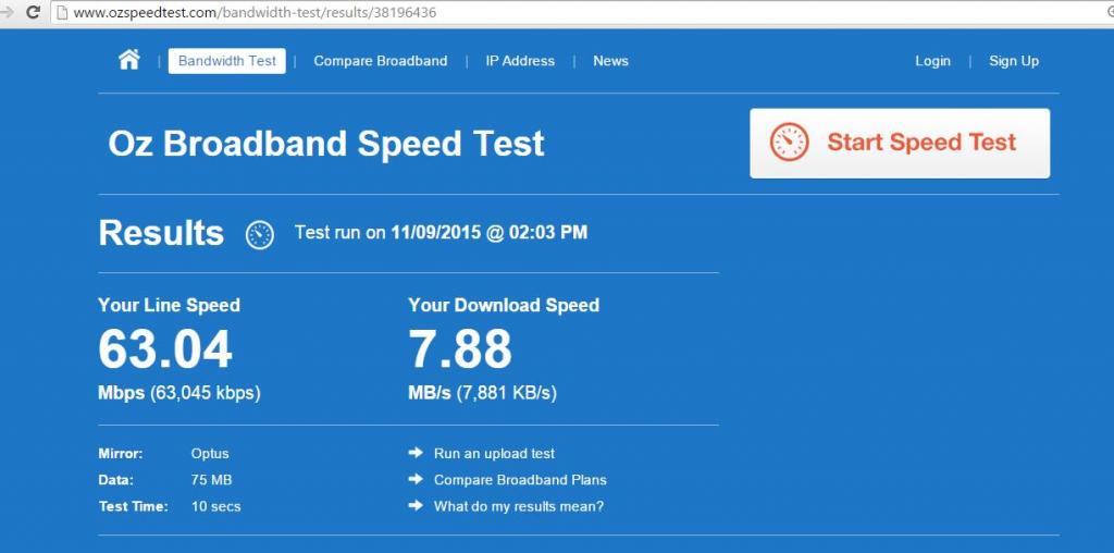

I can now connect using Band28 at 700MHz again.
Initially I found LTEWatch a couple of months ago when I first got this Huawei E8372. I wanted to see better/quicker signal info and just fiddle a bit
 Unfortunately I lost Band28 then and have not had time to look at it since.
I have the modem running through a TP Link WDR4300 running OpenWRT - ROOter via USB, but unlike all other USB modems I have it did not allow display of signal info in OpenWRT's GUI, So I found LTEWatch-H.
I now have two of these modems. The one that had lost the Band 28 is a Telstra prepaid one, and another one that is an Optus one that has a Telstra SIM in it. The Optus one is unlocked when you buy it. It worked and I left it alone - no fiddling around.  I can pickup Band 28 on both Optus and Telstra here now, but am locked into contracts with Telstra for another year or so. When the contracts are finished I will be looking more at Optus as they are lots cheaper.
